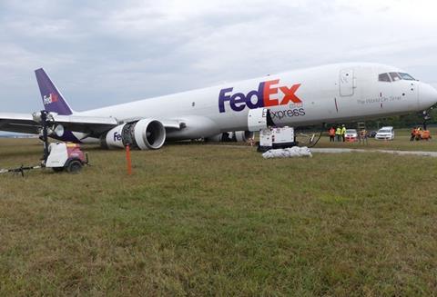

With neither the primary nor alternate extension systems available, the 757 was forced to land gear-up
According to the National Transportation Safety Board, there was “no electrical continuity” between the alternate gear-extend switch and a power pack that releases the landing-gear doors – after which the landing-gear freefalls into place.
The inquiry traced this failure to a break in a wire between the switch and a circuit-breaker, consistent with tensile loading

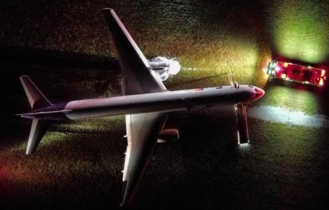

With the landing-gear unavailable, the crew prepared for a gear-up approach to Chattanooga’s runway 20.
It touched down initially on its left-hand Rolls-Royce RB211 engine about 1,650ft from the threshold, with marks from right-engine contact appearing 735ft further on.
Scraping from the aft fuselage occurred about 4,500ft from the threshold, and the aircraft overran, coming to a halt 830ft beyond the runway end.

After overrunning, the jet came to rest 830ft beyond the runway end
Neither pilot, nor a third occupant on the jumpseat, was injured during the 4 October 2023 accident.
But the 757, a 1988 airframe which was converted from passenger configuration in 2015, suffered substantial damage, particularly to the engine and aft fuselage undersides.
