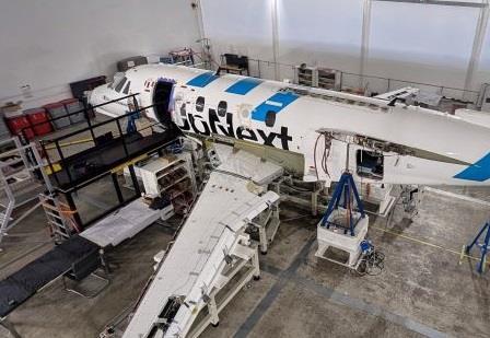

Airbus’s UpNext division has shown off the initial installation of the ‘eXtra Performance Wing’ on a Cessna Citation VII executive jet.

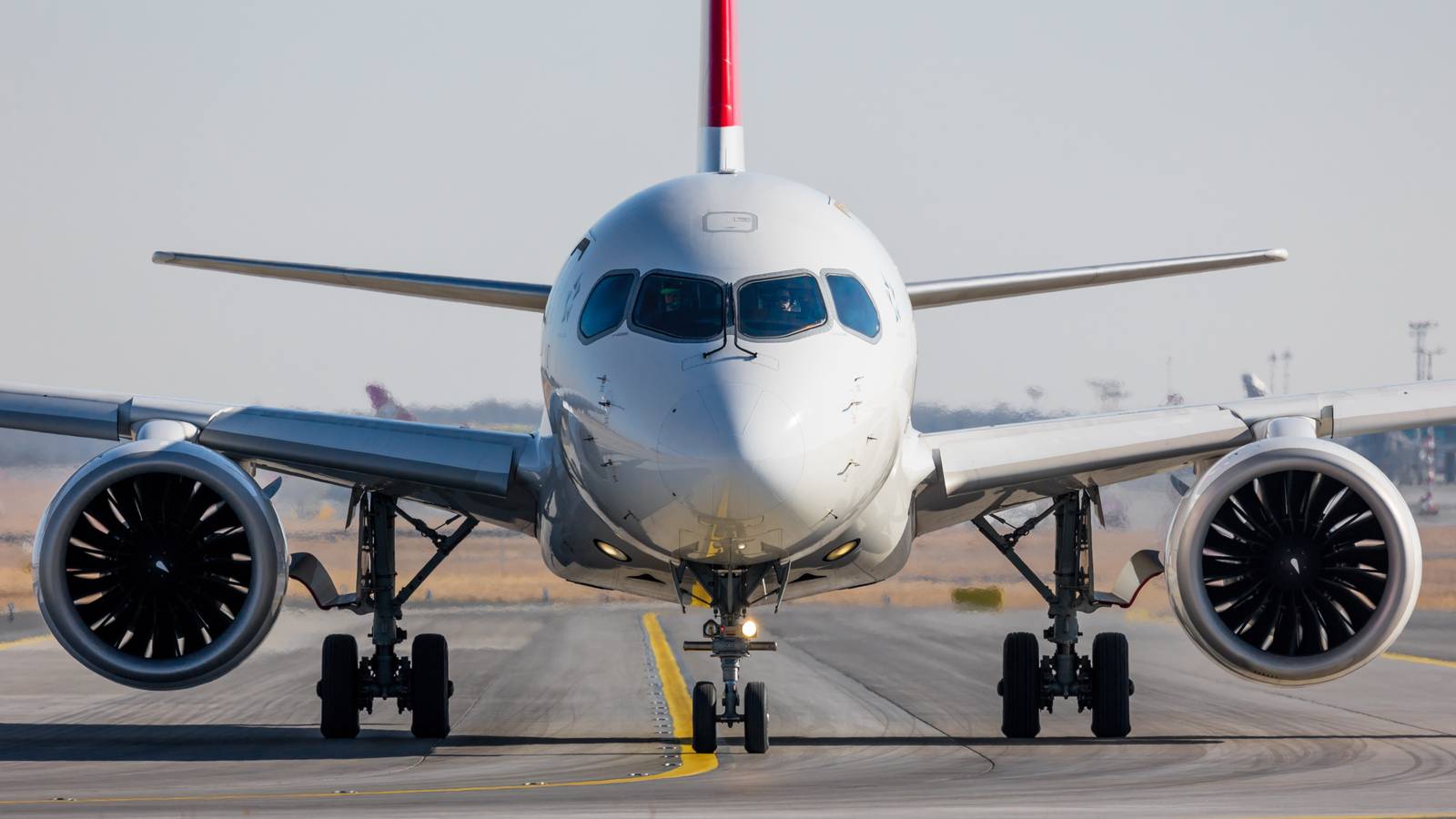

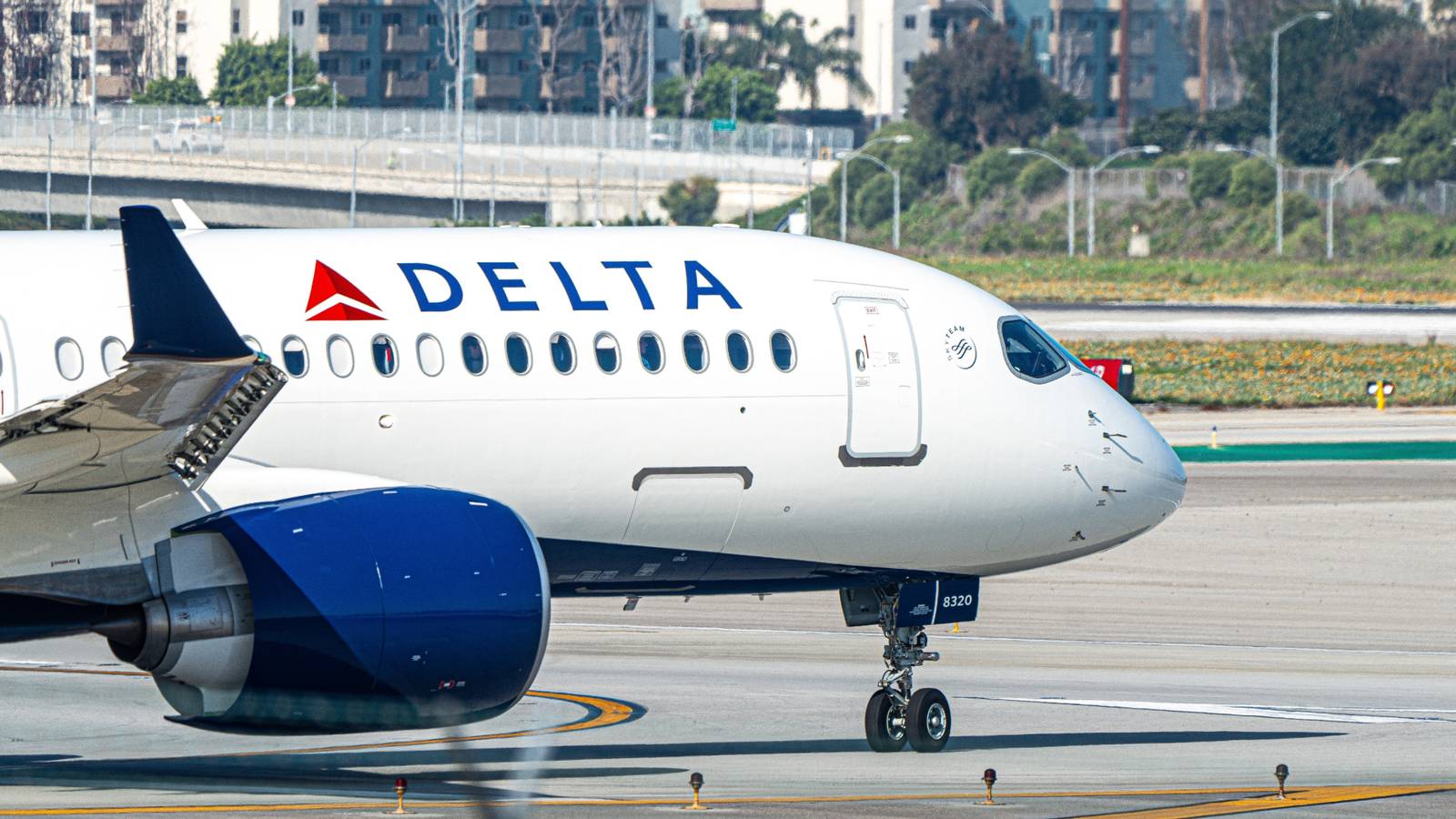

Airbus will have completed “very advanced studies” of the long-planned stretched A220 by year-end, according to Airbus Canada CEO Benoit Schultz. The airframer has for some years been studying the possibility of a larger A220—an option that the program’s former owner, Bombardier, had planned from the start—but Airbus has not yet decided to launch it formally. Key customers, such as Air Canada, Delta and Air France, have upped the pressure on Airbus to proceed with the project. The stretch would provide them with a new-generation aircraft that seats about 180 passengers, roughly the same size as the A320neo or the Boeing 737-8.
Comae airliner program update p. 20 LOT'S Airbus deal and the new order environment p. 22
“I am in favor of the stretch,” Schultz said on the sidelines of the Paris Air Show, noting that to meet market demand, the aircraft should enter service no later than “slightly after 2030.” He is “more and more convinced” that the type can add value to airlines. However, some major questions remain, the most important one being whether “we need an engine with a higher capability,” he said.
The A220-300, like the -100, is powered by the Pratt & Whitney PW1500G engine. But Airbus could add a second engine manufacturer as part of the stretch project, Schultz says.
The A220-300 has a range of 3,400 nm, according to the airframer, and one of the discussion points among Airbus and its customers has been the extent to which a larger version needs to retain that range. Some carriers, including Air France and Delta Air Lines, have been pressing for minimal change because they do not need that range. Schultz said the airframer anticipates no major change beyond possibly a higher-thrust engine. The wing in particular will remain the same size but could be retwisted for aerodynamic optimization.
As an interim step, Airbus is moving ahead with the 160-seat version of the A220-300, another project that Bombardier had anticipated for what it called the C Series. The high-density version of the -300 has 11 more seats than the current maximum of 149 and will be available beginning in 2027.
