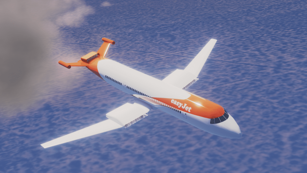

Wright Electric’s Wright 1 aircraft will use 12 motors of various sizes and ducted fans in its propulsion system, which will be powered by swappable battery packs. Engler said that he believed battery technology is developing fast enough to meet the needs of the aircraft in 2030.
Wright Electric concept
Wright Electric’s Wright 1 narrowbody electric concept aircraft is being developed with airline EasyJet (Image: Wright Electric)
“The most challenging part will be making everything work at high altitude, where the air is thinner. You have to do your insulation and wiring differently,” Engler said.
“2030 is an ambitious but reasonable goal that will require the dedicated and tireless effort of our internal team and our partners. There are a lot of people working to making this happen and help move the industry forward.”
